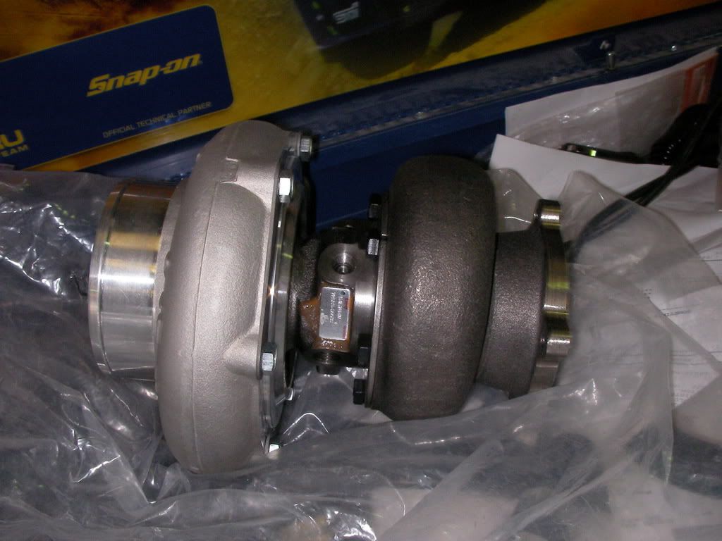

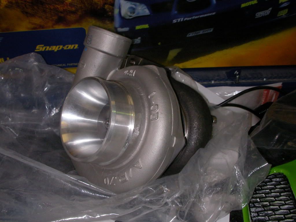

THEN AFTER A 1 WEEK ID BEEN PLAYING WITH IT AND ON THE STANDARD ECU WITH A VF30 TURBO I GOT IT TO 348BHP
AFTER ONLY 20 MILES IT WAS TIME TO START THE REAL WORK I HAD INTENDED USING A GT3082R TWISTED ON A FORGED 2L
BUT THEN THIS CAUSED PROBLEMS WITH MASSES OF LAG SO RETHOUGHT THE IDEA OVER XMAS AND AFTER TALKING TO A FEW CRAZY AMERICANS I DECIDED THAT THE ONLY WAY I WAS GOING TO RUN A BIG TURBO ON A 2L WAS TO PUT THE TURBO IN THE FRONT BUMPER TO SHORTEN THE ROUTE.

SPEC:
CLOSED DECK 2L
V4 STI CRANK
ACL RACE BEARINGS
EAGLE RODS
OMEGA PISTONS
ARP ROD AND HEAD STUDS
COMETIC GASKETS
STANDARD V4 STI HEADS.
CUSTOM HEADERS
GT3082R
CUSTOM EXHUAST
EXTERNAL WASTEGATE
AQUA MIST WITH METHANOL 50/50

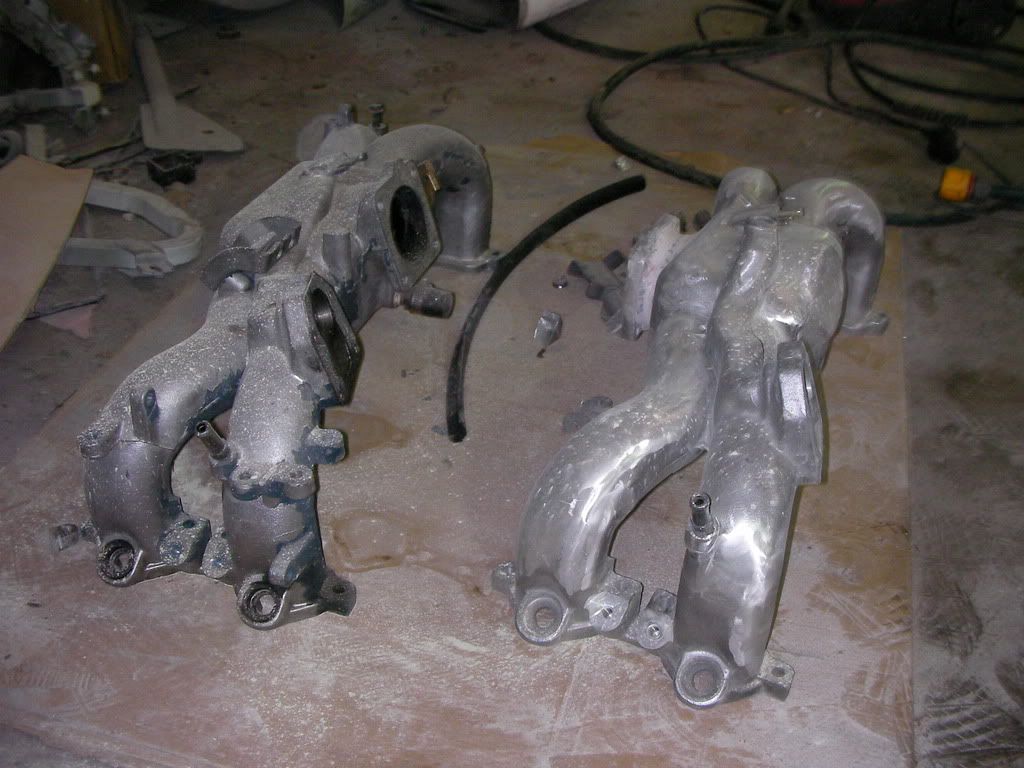

REVERSED INLET.
THATS THE BASICS FOR THE ENGINE
ECU IS A POSUM BOURNE LINK.. THIS WILL RUN A CONSTANT MILD ANTI LAG. IN WHICH YOU OPEN THE THROTTLE BODY WITH THE ADJUSTER SREW TO .10 OPEN, THEN RETARD THE SPARK AND YOU HAVE MILD ANTI LAG.

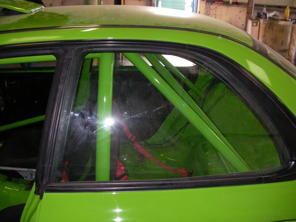

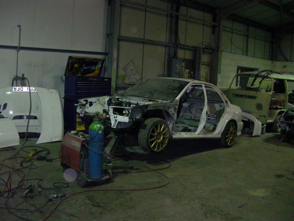

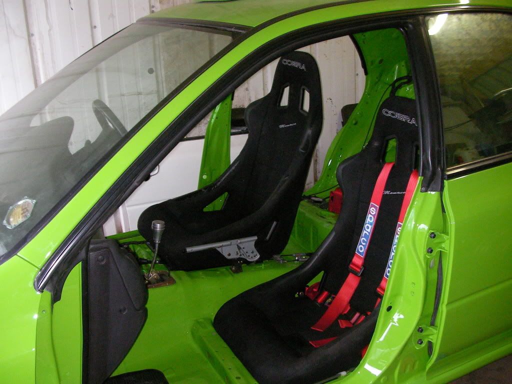

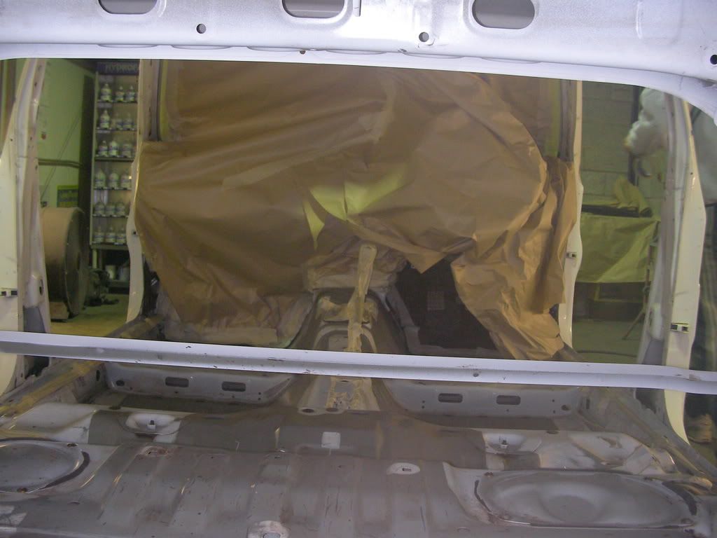

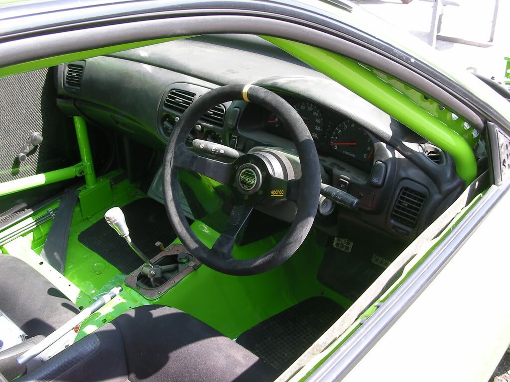

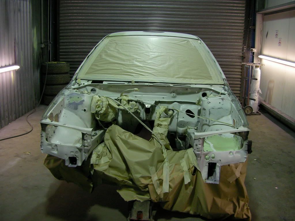

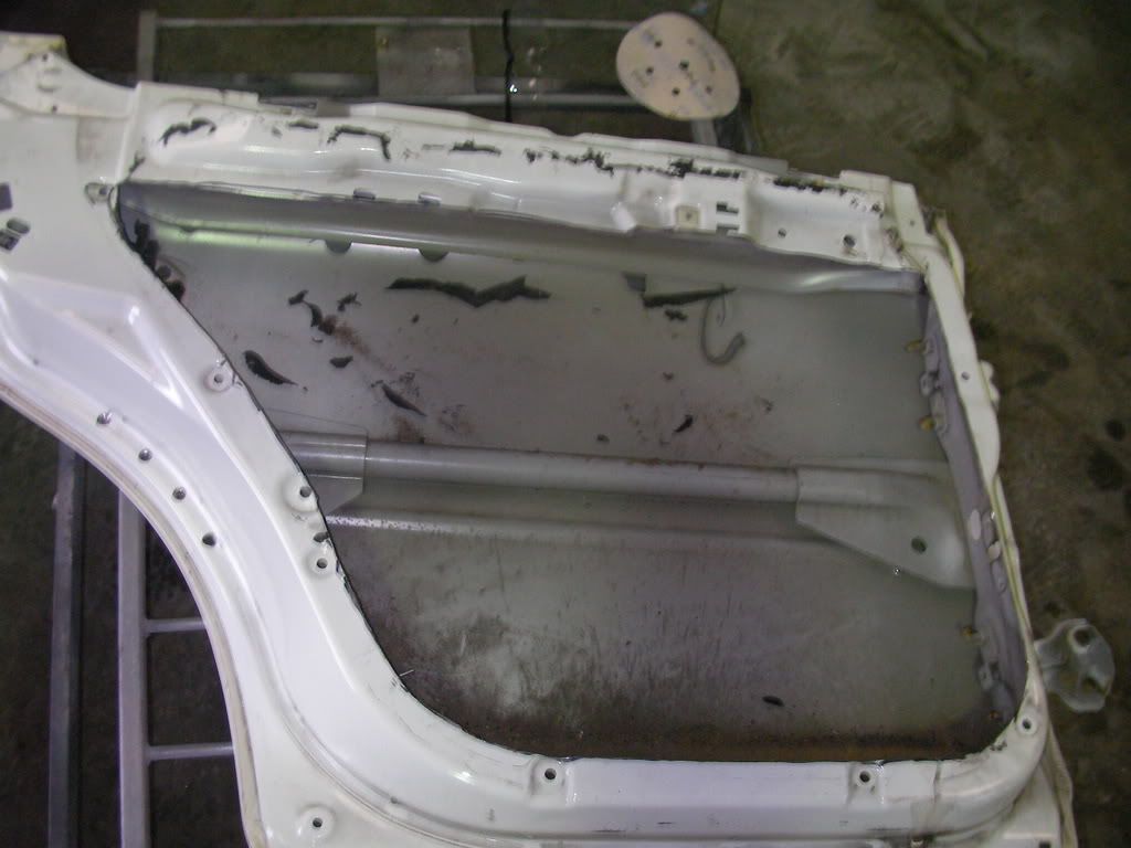

I HAVE NEARLY FINISHED THE ENGINE BUILD SO IT WAS TIME TO START THE SHELL. STRIPING THE WAIGHT OUT AND GETTING IT READY FOR THE CAGE AND TWO BUCKET SEATS.
I HAVE REMOVED THE FRONT CHASSI MEMBER TO ALLOW FOR THE TURBO I HAVE ALSO REMOVED 3.3" OUT OF THE DEPTH OF THE LEG. I STRENGTHEND IT ALL AND THEN BOXED THE LEG BACK UP.
NOW TIME FOR PAINT PREPERATION. WHILST I WAS DOING THIS I HAD MY MATE THE AUTO ELECTRIAN REMOVE ALL THE WIREING I DIDNT NEED.

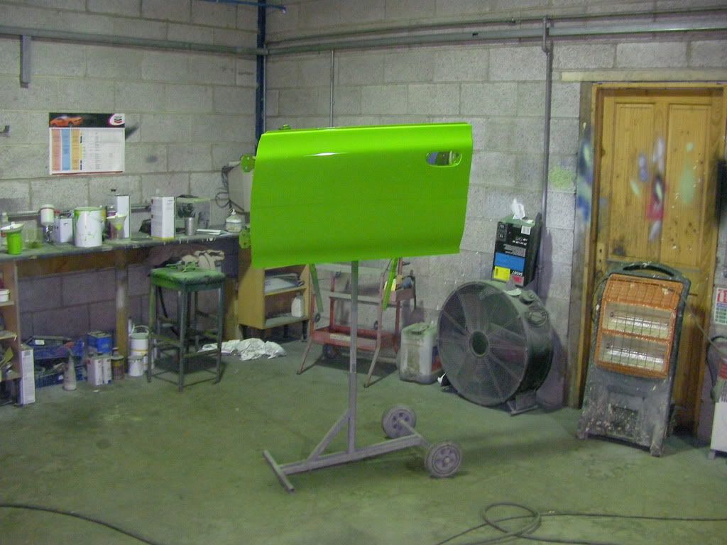

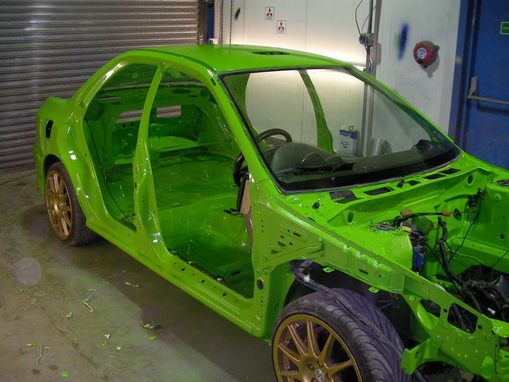

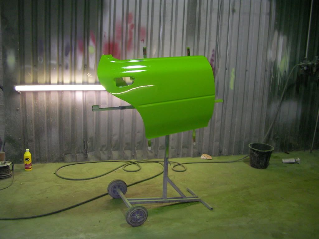

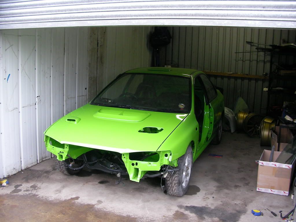

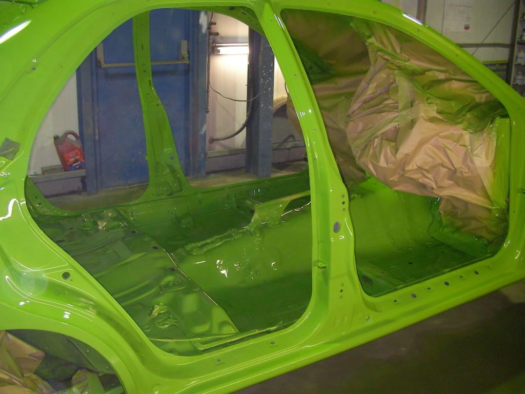

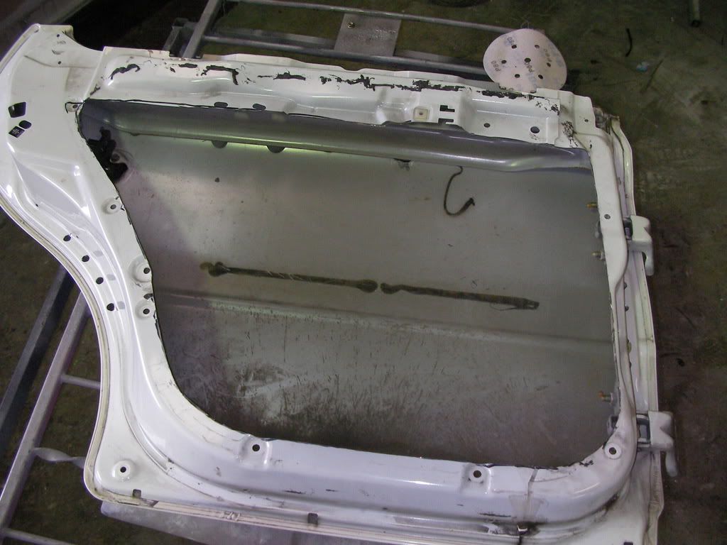

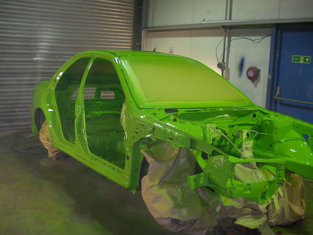

REMOVING ALL THE SOUND DEADING WAS A NASTY JOB BUT WELL WORTH DOING. THEN IT WAS INTO THE BOOTH FOR PRIMING AND PAINTING.
THE COLOUR. WELL IM NOT ONE FOR BEING THE SAME I LIKE TO BE DIFFERNT. AND ONCE SEEN NEVER FORGOTEN.
SO WHAT DO YOU THINK SO FAR.

BENN GETTING THE PANELS READY

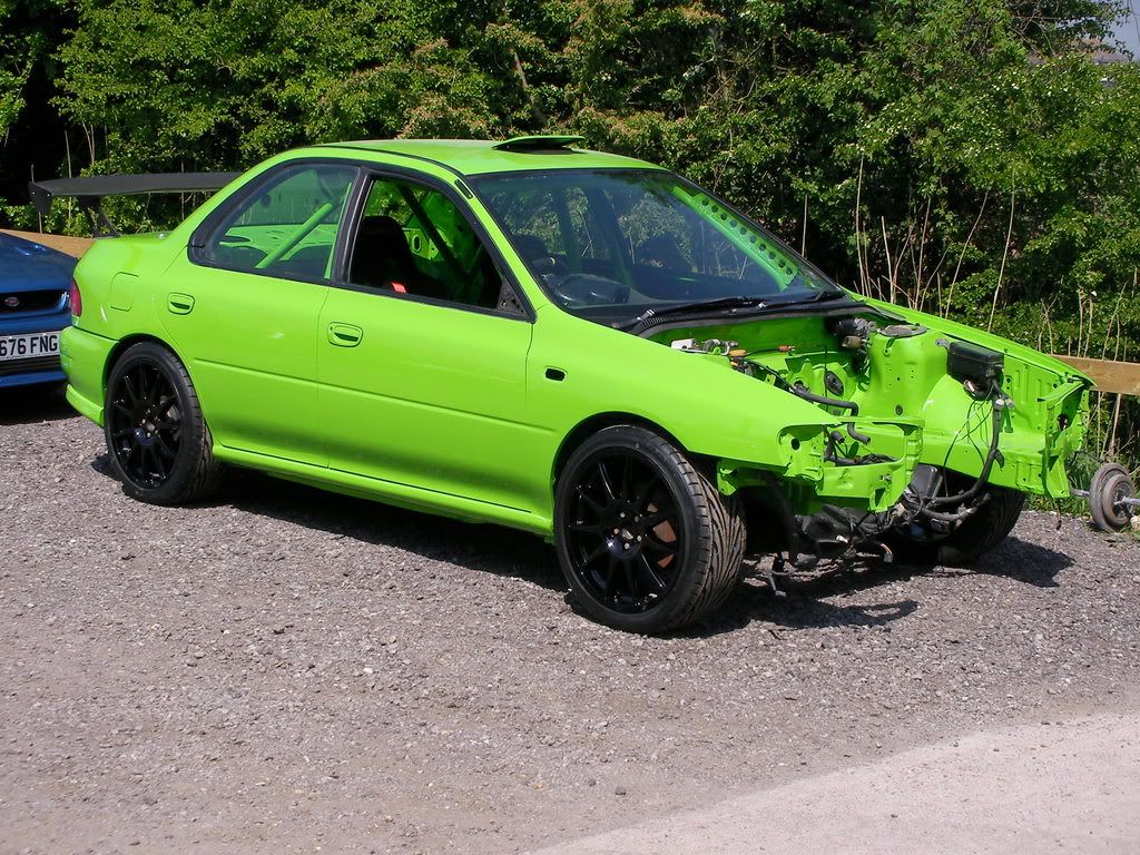

getting them ready for paint to go on a special car haha.
painted
got my reversed inlet back and started removing all the brackets i dont need.
next to a standard one to compare...

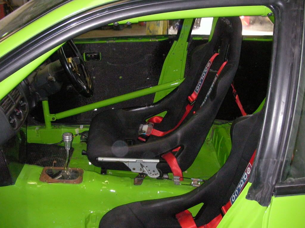

few bits back on the car

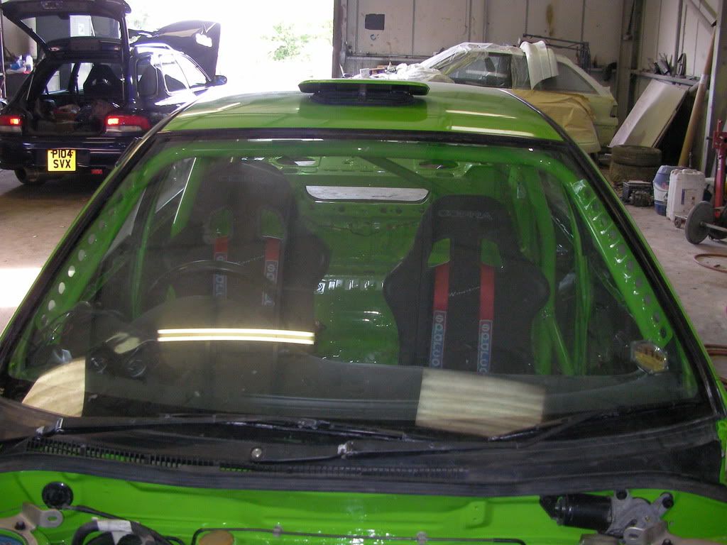

fitted the seats. drivers side to were i need it and the passenger one to the floor to keep centre of gravity down rolleyes.gif
